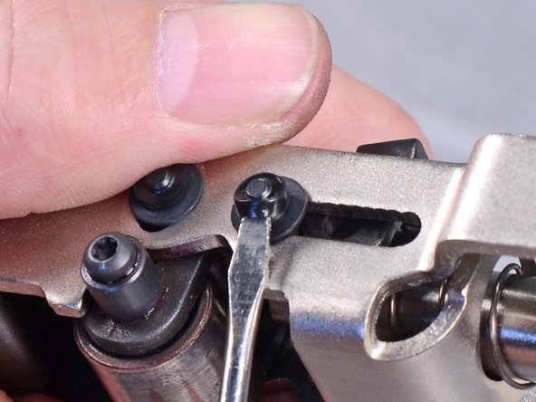

Transfer the minor components
  • Use a flathead screwdriver to pry off the rubber stopper securing the plunger pin.
  • Retain the rubber stopper and washer for your replacement assembly.
