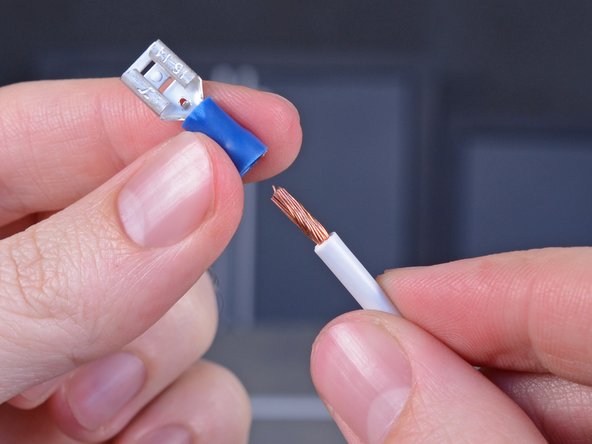

  • If your replacement power cord does not have quick disconnect plugs on the end of its wires, strip about half an inch of insulation off of each wire to install new crimp connectors.
  • Reassembly tip: This needs to be done after the cord is fed back into the cutting head, otherwise it won't fit.
