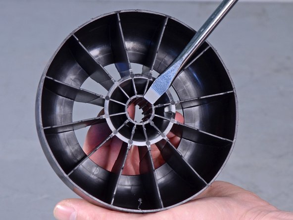

Karcher Rotary Floor Cleaner 17833080 2017 Drive Motor Replacement, Remove the blower wheel: crwdns2935265:00crwdnd2935265:01crwdnd2935265:03crwdne2935265:0 Karcher Rotary Floor Cleaner 17833080 2017 Drive Motor Replacement, Remove the blower wheel: crwdns2935265:00crwdnd2935265:02crwdnd2935265:03crwdne2935265:0 Karcher Rotary Floor Cleaner 17833080 2017 Drive Motor Replacement, Remove the blower wheel: crwdns2935265:00crwdnd2935265:03crwdnd2935265:03crwdne2935265:0
  • When you pry the blower wheel, try to apply pressure as close to the center of the wheel as possible.
  • Use a large flathead screwdriver or pry bar to pry the blower wheel off the motor axle.
