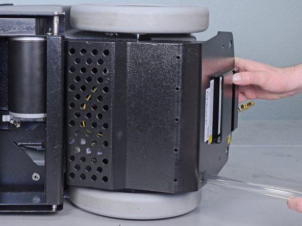

  • Rotate the bottom cover down toward the bottom of the carpet cleaner, then pull it straight back toward the rear of the carpet cleaner to remove it.
  • Don't completely remove the cover yet. There is a ground wire connecting the cover to the carpet cleaner that must be disconnected first.
