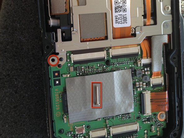

  • With the camera body face down, begin removing the screws securing the sensor assembly.
  • Remove the long screw in the lower center of the camera.
  • Remove the remaining 3 screws shown in the photos.
