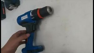

      Remove the battery and the mandrel. Loosen the screws with a T10 bit or a T10 screwdriver.
      crwdns2936071:02crwdne2936071:0

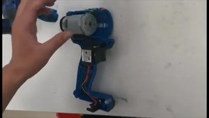

      Remove the top shell and then separate the Gearbox from the Engine.
      crwdns2936071:03crwdne2936071:0
      Remove the protective cover from the new Gearbox and then assemble it to the engine while respecting the demers. Reposition the LEDs if necessary.
