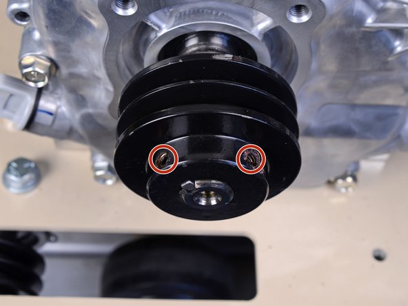

Remove the Drive Pulley
  • Use a 1/8-inch hex key to loosen the two set screws on the engine's drive pulley.
  • Completely removing the set screws is not required to remove the drive pulley.
