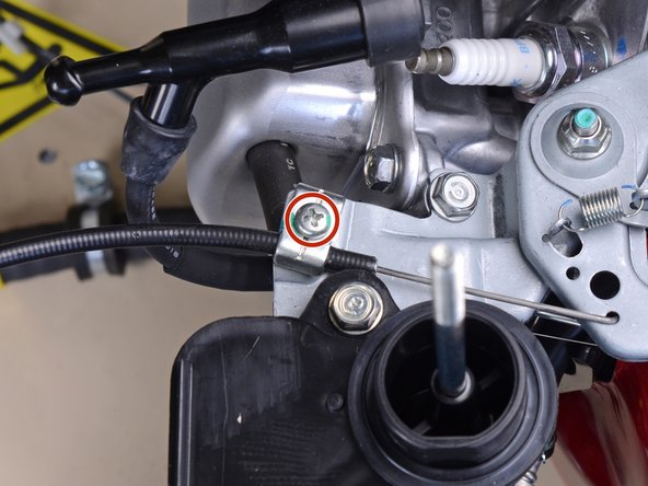

Remove the Throttle Cable
  • Use a Phillips #2 screwdriver to remove the screw securing the throttle cable to the engine.
  • Grab the throttle cable clamp with your fingers and rotate it out of the way of the throttle cable.
