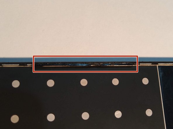

  • Remove any old adhesive residue from the front of the phone and set the old screen aside.
  • You can use a spudger to help scrape it off.
  • Reapply 3M 9448A tape to the lips on the inside edge of the phone. Cover as much surface area as possible.
  • During reassembly, use a pair of tweezers to install the new adhesive.
  • Don't touch the tape with your fingers or the adhesive will lose strength.
  • Remove the front backing and you're ready to install the new screen.
