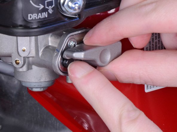

Drain the Gasoline from the Carburetor
  • The next two steps demonstrate how to empty gasoline out of the carburetor before removal.
  • Press and hold down the fuel valve's safety lock button.
  • Begin to turn the fuel valve knob counter-clockwise, continuing to hold down the safety lock button until the knob clears the button.
