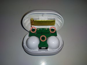

      crwdns2936071:01crwdne2936071:0 — Case opening.
      With an opening pick we will leverage the edge between the interior part in which the earphones are placed and the exterior case. We will surround entire inner part with the opening pick until it comes out.
      crwdns2936071:02crwdne2936071:0 — Board disassembly
      We will unscrew the 3 screws that join the board to the part where we place the earphones (with a Phillips 00 screwdriver).
      crwdns2936071:03crwdne2936071:0 — Assembly
      The Mi Airdots case will be disassembled.
