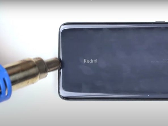

  • Use a heat gun to lightly heat the edges of the back to soften the adhesive that connects the back cover to the rest of the frame.
  • An iFixit iOpener, hair dryer, or hot plate can also be used to heat the edges. Using a heat gun, hair dryer, or hot plate will make the metal frame rather hot to the touch, so handle it with care.
  • Be careful not to overheat the device –the OLED display, battery and other internal parts can be damaged by excessive heat. Approximately one minute should be enough to soften the adhesive.
  • An iFixit iOpener, hair dryer, or hot plate can also be used to heat the edges. Follow the iOpener Heating guide for instructions on using the iOpener.
