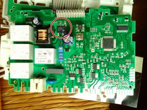

      Symptoms of a faulty control module: No function during the wash cycle (no display, no noise, no reaction to pressing a button or switching it on and off).

      What needs to be replaced on the control module to fix the error?
      crwdns2936071:06crwdne2936071:0

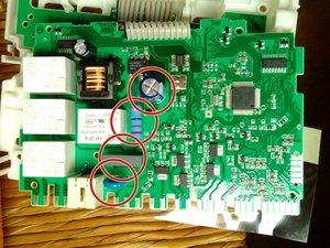

      Change other components that may also be defective due to a chain reaction (these are all primary components for converting the mains voltage):
