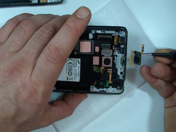

Test the new spare part
  • I prefer to test the new spare part before install it.
  • Transfer the Power button / Loud speaker flex cable.
  • Install the mother board.
  • Test the display.
  • To prevent damage to the put back the back frame before the test.
