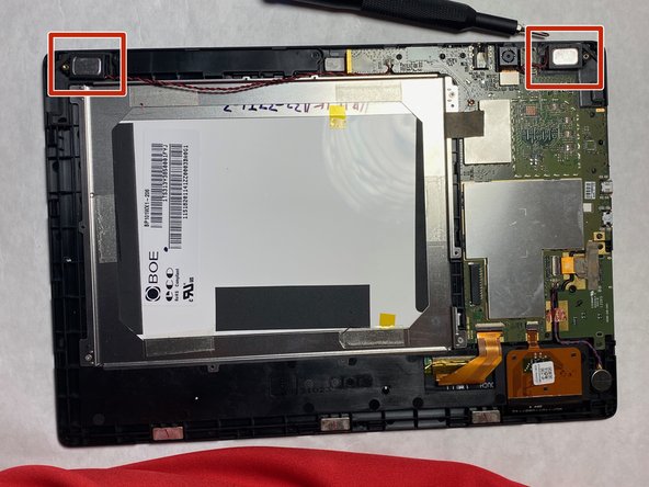

  • Use an opening tool to pry the speakers out of the tablet.
  • The speakers are connected to the tablet by glue and require a lot of prying to remove.
