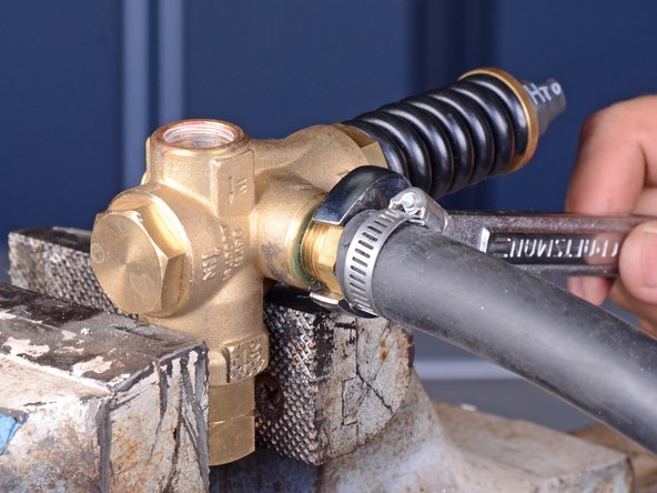

Loosen the return hose nipple
  • Use a 11/16" or adjustable wrench to loosen and unscrew the return hose nipple from the unloader.
  • You do not need to disconnect the hose from the nipple.
