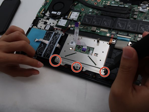

  • Remove the three screws securing the touchpad bracket to the keyboard assembly using the Phillips #0 screwdriver.
  • Lift the touchpad bracket.
