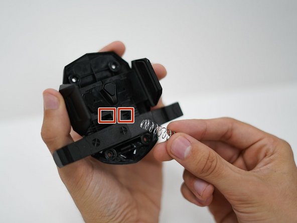

  • Insert two new 2.6 cm springs as you would batteries to a tv remote. Be cautious as to keep the chassis in place during this process.
