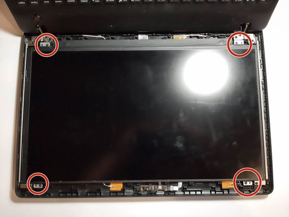

  • Using the Phillips #0 Screwdriver, remove the four screws holding the screen in place.
  • At this point, the screen will be free to move around.
  • The LCD LVDS cable is still connected. Be sure to not damage this by keeping the screen still.
  • Turn the device over (right side up) and let the screen lie face down on the keyboard.
