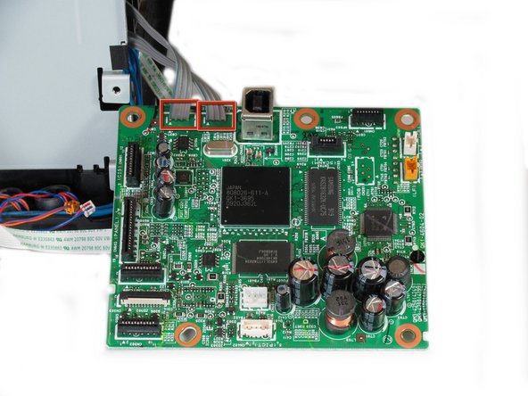

  • Once all wires and screws have been removed, gently take the motherboard out of the printer.
  • These wires are soldered onto the bottom of the PCB and must be de-soldered in order to completely detach the motherboard from the printer.
  • If you do not know how to operate a soldering iron, do not attempt to finish this guide.
  • De-solder these eight solder joints on the bottom of the motherboard.
  • When reinstalling the motherboard back into the printer, solder the highlighted joints (in orange markers in the second photo) back onto the board.
