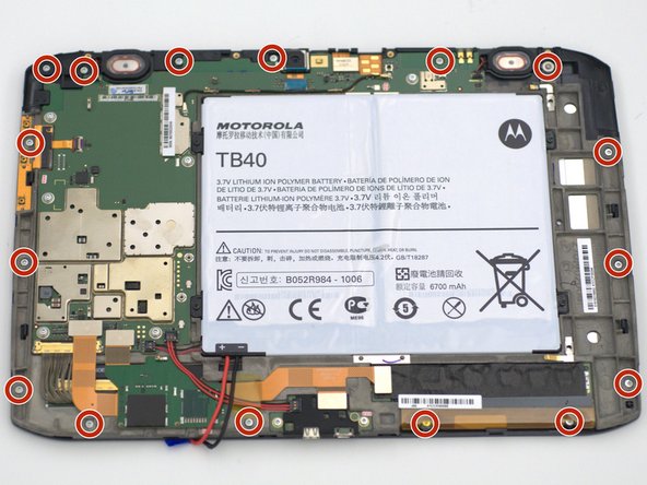

  • Unscrew the sixteen (16) 1.5mm screws using the T5 Torx screwdriver.
  • Two of the screws were previously hidden behind the digitizer connector.
  • The screw located in the top right of the device has a washer attached.
