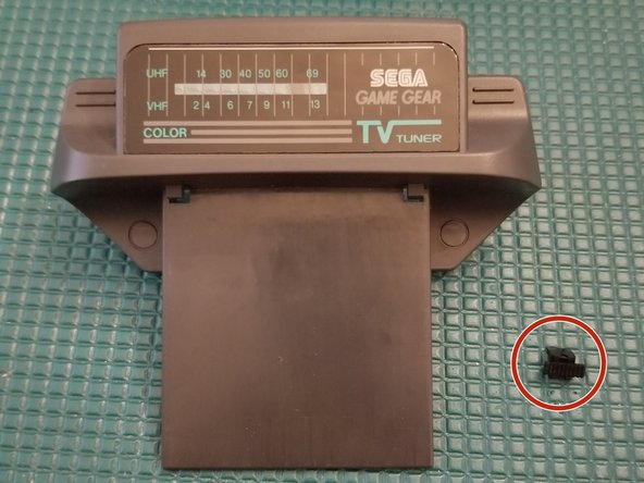

Remove PCBs
  • When removing the front shell be careful not to lose the frequency switch button located on top of the device
  • If it makes your repair easier you can separate the two PCBs by gently pulling the ribbon out of its connector. This is a friction fit cable
