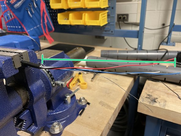

Stripping Pressure Transducer Wires Cont.
  • Continue stripping off an inch or so at a time until you have stripped off 6-8 inches of black shielding.
  • Use wire cutters to cut the blue wire and plastic strips with every piece of black shielding that's removed (will make it easier to remove shielding as you go on).
  • Cut about 3-4'' off of the red sensor wire before stripping. This will allow all wires to be aligned once voltage regulator and additional wires are soldered on (Step 20).
  • Use wire strippers to strip off about 1/4 inch off of the black and red wires.
  • The stripped wire should now look like this.
