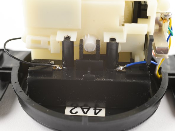

  • Unfortunately, the battery contacts are soldered to the motor assembly, so any repairs or replacement of the motor will require a soldering iron and some basic soldering skills to remove it entirely.
  • But once those two wires are removed, separating the motor assembly from the base is a cinch.
