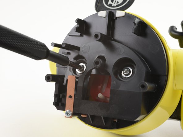

  • Just two screws hold Robie's head to its body. After removing those, we can carefully lift the head up and set it off to the side.
  • These two screws are still accessible without removing Robie's head cover and eyes. So you can detach the entire head assembly in one piece if you need to get inside more quickly.
