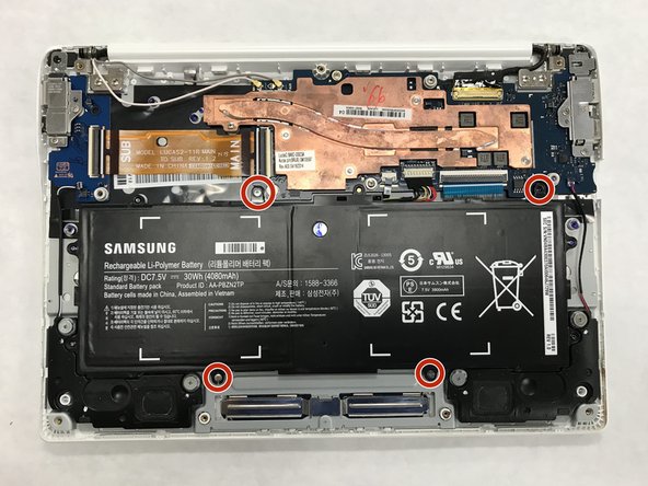

  • Remove the four 3 mm screws using a Phillips #000 screwdriver.
  • Carefully lift the top of the battery then pull it away from you to remove it.
  • Some batteries may be attached via a battery connector. Disconnect the battery connector by simply pulling straight up at its base.
