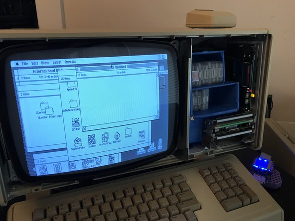

Installing 800K Floppy Drive
  • Attach the 800K Floppy Drive to the 800K Drive Bracket. If you do not have an official 800K bracket then you can be create and fashion one yourself as displayed in the image.
  • Reattach all Drive Cage wires.
  • Slide Drive Cage back into the Lisa.
