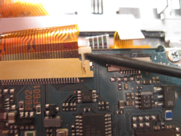

  • Next I removed the wide ribbon that connects the interface to the circuit board. Lifting up on either side of the connectors two white tabs releases the ribbon.
