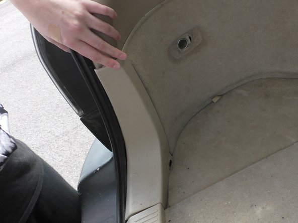

Remove Latch Covering
  • Pop off the covering located near the latch on the driver's side of the trunk.
  • Underneath you will find 2 small black plugs keeping the upholstery attached to the car's frame. Remove them using the screwdriver to pry them out carefully so as not to damage the plugs.
