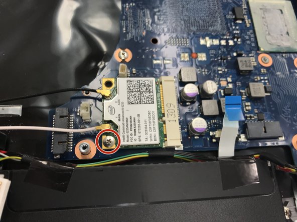

  • Use the Phillips #0 screwdriver to take out the one 3 mm screw.
  • Take out the Wi-Fi Card.
