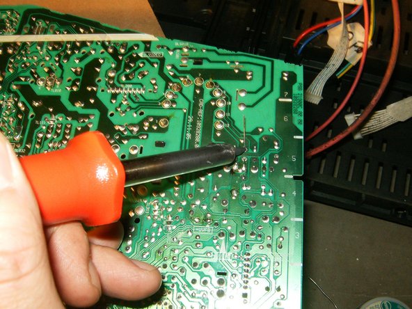

  • Replace the components by guiding the legs through the holes in the board. Bend the legs to the side to keep the component in place. Solder in the usual way.
  • After the component is properly solder to the board, cut the excessive length of the contacts with a pair of side cutters.
  • The only other thing I recommend is to either reflow, or resolder the flyback transformer contacts. The ones on this board looked like they may have gotten hot.
