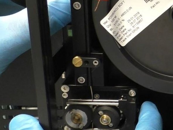

Wire Bonder Thread Spool Replacement, Automatic feeding: crwdns2935265:00crwdnd2935265:01crwdnd2935265:01crwdne2935265:0
Automatic feeding
  • Push the spring of the outfeeder and the "Feed and Capture" button simultaneously for automatic feeding.
  • Make sure that the rolls of the outfeeder are close together so that the wire is gripped firmly.
  • Before starting automatic feeding, turn off "Run or Service" and activate "Feed or Capture".
