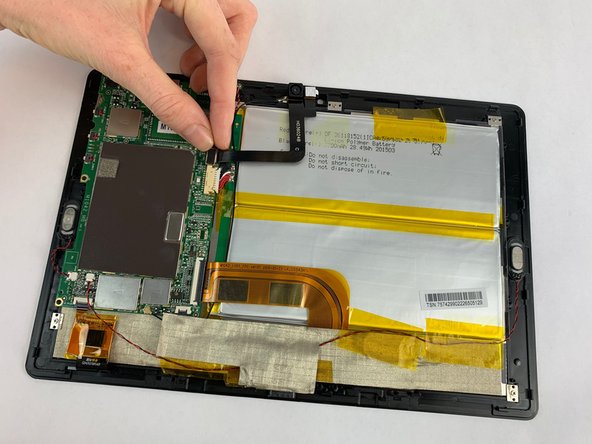

  • Pull the camera plug upward and away from the motherboard with your fingers.
  • Gently pull the camera from the device. The camera is held by tension.
