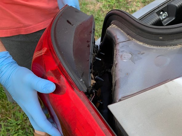

  • Once the wires are disconnected facing the bumper, firmly grasp the entire plastic casing of the tail light and pull directly towards your hips in order to not catch the hidden clip located on the side of the car near the end of the tail light casing.
