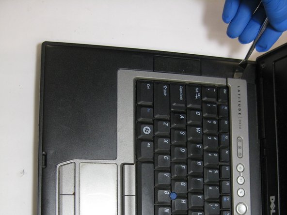

  • Open the laptop up. Displaying the keyboard and screen.
  • Take a spudger and insert it under the left edge of the panel between the keyboard and screen.
  • Use the spudger to pry under the panel.
