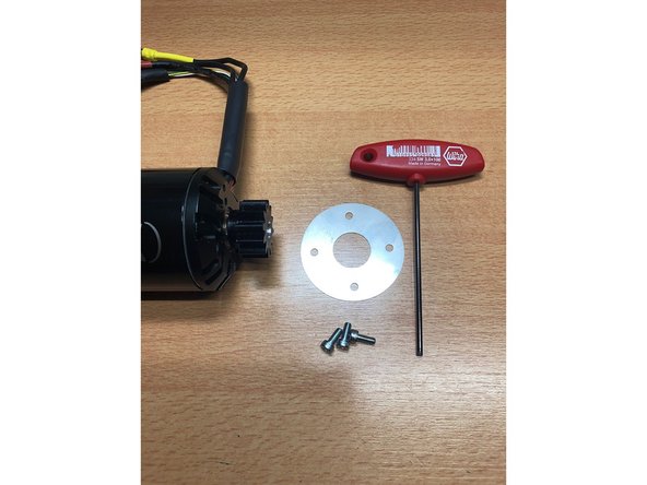

Attach motor to baseplate
  • Use 3xM3 bolts to attach motor to the baseplate
  • Don't forget to use Loctite on threads
