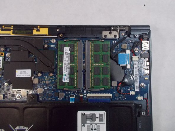

Perform the previous steps in the reverse order to install two new sticks of RAM into the DDR3 slots. Make sure that the clamps click back in place. Failure to do so could result in non responsive sticks of RAM. If this is an issue, not to worry. Try taking the clamps off and reinstering the RAM.
