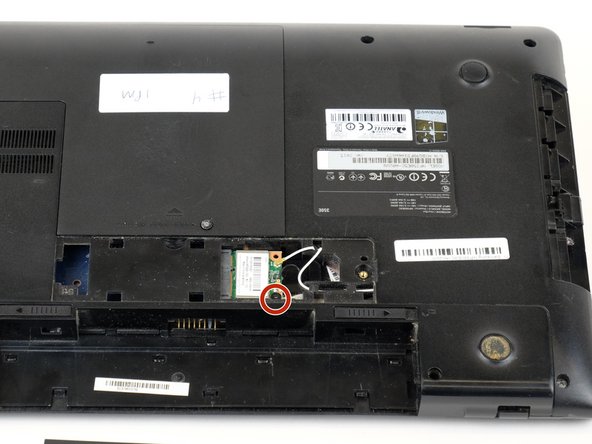

Samsung NP350E5C-A02US Wifi card Replacement

  • Using the Phillips #0 screwdriver, remove the M2.5x3 mm screw holding in the Wifi card.
