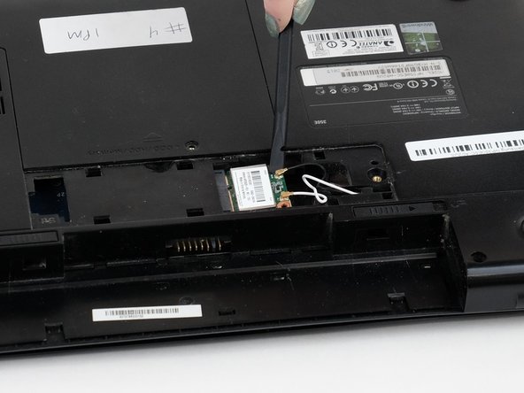

  • Gently remove the two wires attached to the Wifi card by using a plastic opening tool or plastic spudger to pry up from under where the wire is attached.
