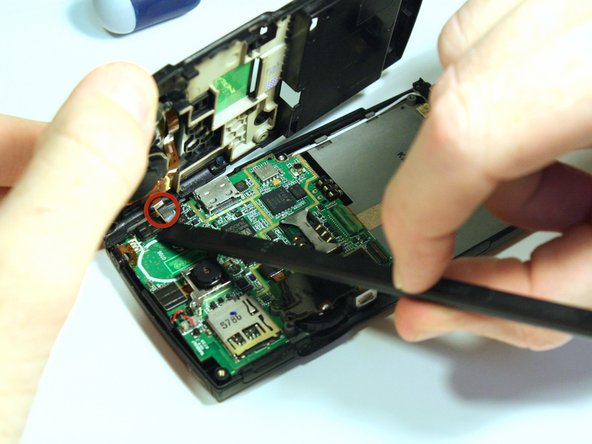

  • Use the spudger to unsnap the gold wire connection that connects the back casing to the logic board.
  • Use the spudger to unsnap the gold wire connection that connects the scroll wheel assembly to the logic board.
