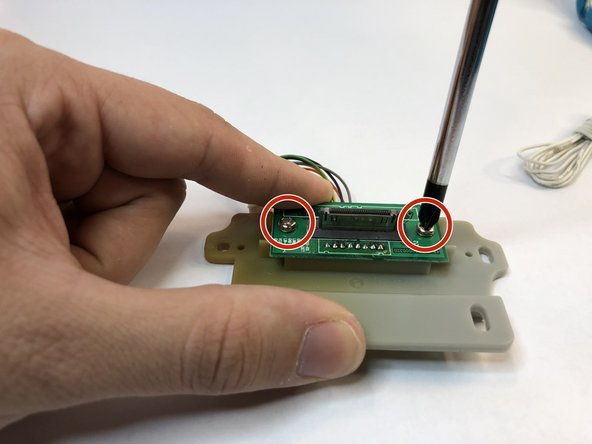

  • Unscrew the two 10 mm Phillips #2 screws and remove the dock and chip.
  • The wiring harness is loaded through the bracket, so be careful when removing the chip.
