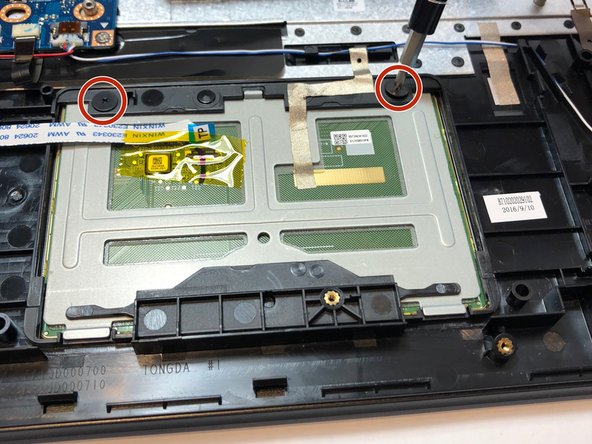

Lenovo Ideapad Flex 4-1570 Touchpad Replacement
crwdns2935425:01crwdne2935425:0
crwdns2931653:01crwdne2931653:0
Lenovo Ideapad Flex 4-1570 Touchpad Replacement: crwdns2935265:00crwdnd2935265:01crwdnd2935265:01crwdne2935265:0
  • Locate the touch pad and remove the two 3 mm screws using a T5 Torx Screwdriver.
