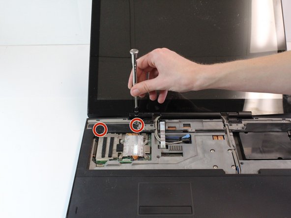

  • Unscrew the two Phillips #1 screws that secure the bracket.
  • The screws are held to the bracket by a washer and cannot be removed.
  • Use your hand to remove the bracket.
