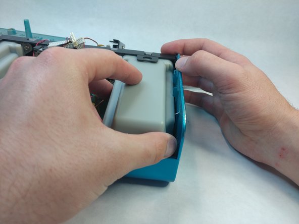

  • To remove the speakers from the iHome, gently lift up the back of the speaker and pull towards you. These are very secure so minor shaking may help release the speaker.
  • Repeat for the other side.
  • Be careful yanking on them, the speakers are connected together.
