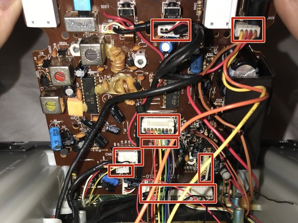

  • Carefully tilt the motherboard up from the front.
  • Disconnect the 8 connections by gently pulling on them. Starting from the front and work your way backwards.
  • All 8 connectors disconnected.
