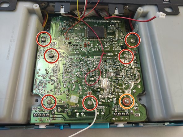

  • Remove the seven screws that are holding the motherboard in place:
  • Six 14 mm Phillips #2 screws.
  • One 14 mm Phillips #2 screw with two rubber washers on it.
