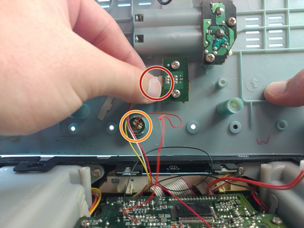

  • Disconnect the final connector pin series and carefully set your lid behind the body of the iHome.
  • The tiny speaker will not be disconnected for this repair, but you can easily remove it from the lid by means of a paperclip from the outside. While not necessary, this can help prevent damage to your device.
