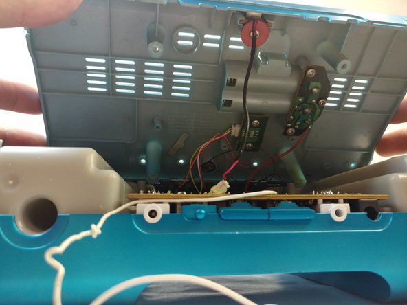

  • Slowly tilt the bottom cover of the iHome up.
  • Do not yank the cover off, there is a wire connecting the cover to the circuit board.
  • Disconnect the wire just by pulling on the connector gently.
