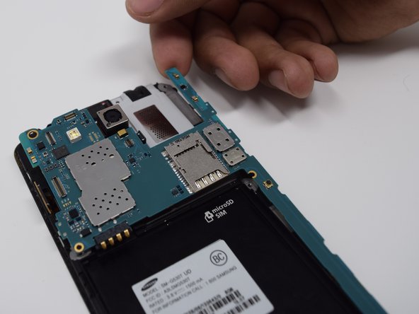

  • The mother board should now be free to remove.
  • Carefully lift each edge and lift to remove.
  • Flip the mother board over and use a plastic spudger to disconnect the rear facing camera ribbon connector to free the camera.
  • Make sure not to overly bend the ribbon connector.
