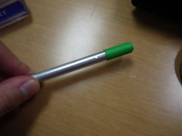

  • Slide the hop-up bucking onto the barrel, making sure to line up the protrusion in the bucking with the slot in the barrel.
  • Slide the barrel into the hop-up unit with the hop-up window facing up. Pop the clip back in place.
